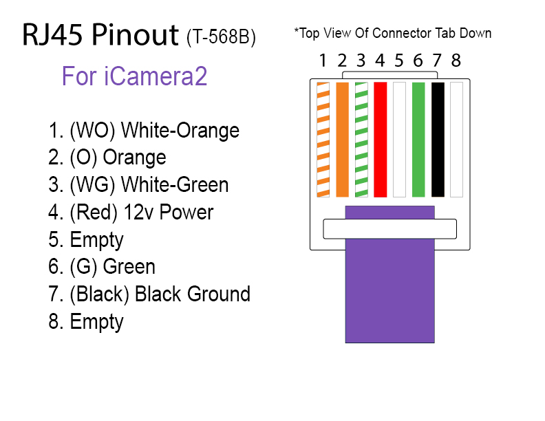

Ethernet Connector Pinout for iCamera2
The Ethernet connector on the iCamera2 requires both Ethernet and 12v 1A power to run wired.
Note:
Please note that this is a custom configuration and the camera is not POE powered but 12v.
A wired connection is needed for initial configuration, after that you may use it over wifi but you still have to provide 12v with an ethernet connector.
The pinout from left to right, with the cable inserting from the bottom (tab down), is as follows:
Pin 1 Pin 2 Pin 3 Pin 4 Pin 5 Pin 6 Pin 7 Pin 8
(WO) (OR) (WG) (12V) Empty (G) (GND) Empty
White-Orange Orange White-Green 12V Red Power Empty Green Black Ground Empty
Pinout iCamera.jpg (126.87 KiB) Viewed 143495 times

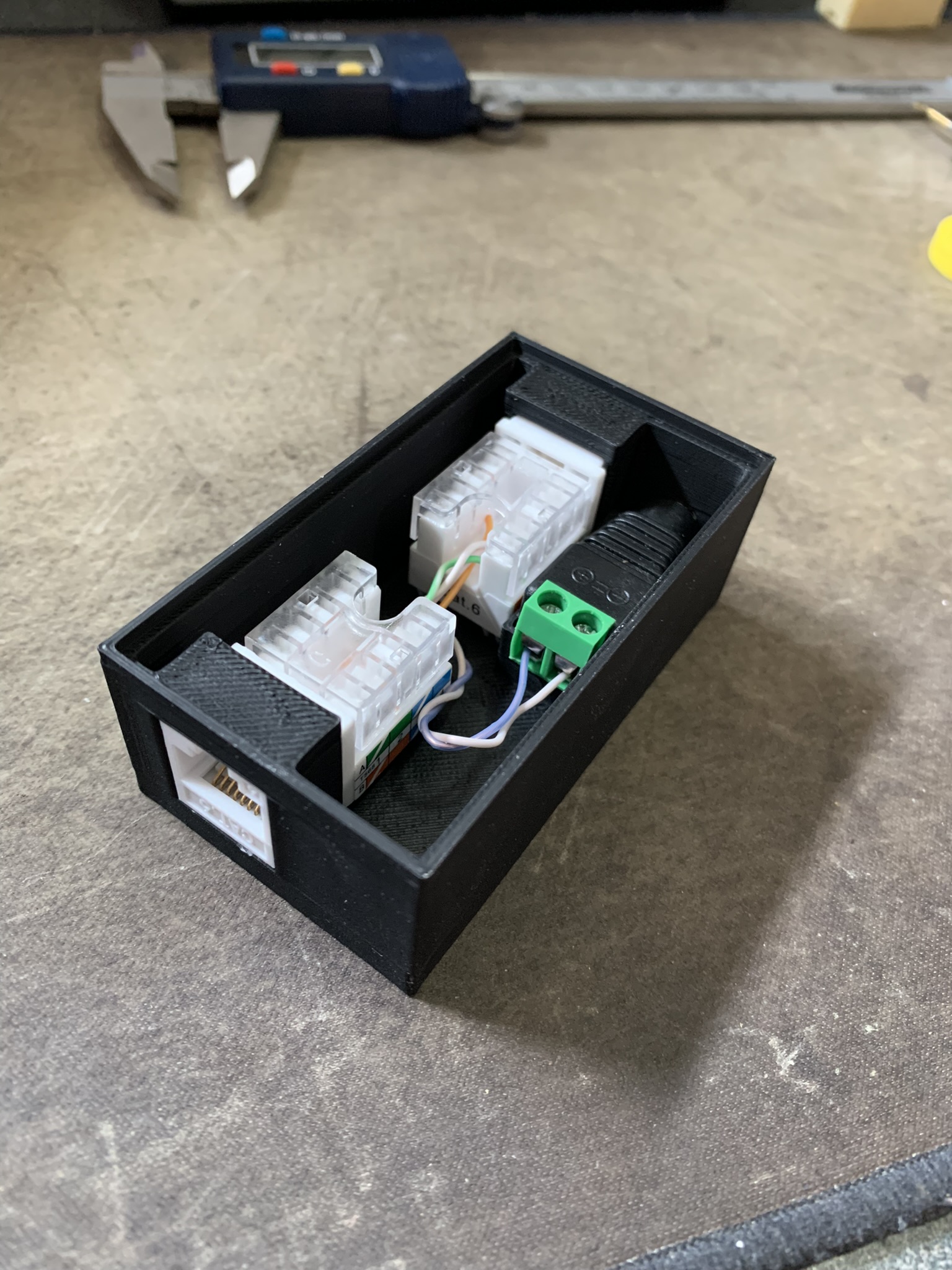

Here is a 3D Printable Enclosure to make a nice looking POE Box:
https://www.printables.com/model/556958 ... e-12v-case

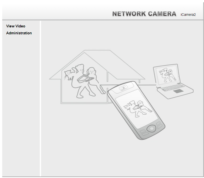

Next, you need to access the iCamera2's web interface.
Open a web browser on your computer and type in the IP address of the iCamera2.
If you don't know what the cameras IP Address is use an IP Scanner like: https://www.advanced-ip-scanner.com/
2023-07-10 23_31_58-Network Camera.png (123.15 KiB) Viewed 143495 times
Click on "Administration"
The default username is administrator. There is no password.
You will now be able to create a new admin user with a strong password.
Note: You will need to log in quickly and change the admin username and password, or ensure that the camera cannot connect to the Internet yet.
Some cameras will "phone home" and reconfigure themselves with the vendor's username & password.
Some cameras don't show the web interface by default and may show a default 404 error page.
