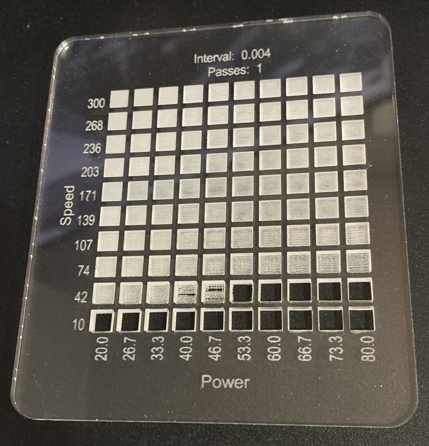

Running a Material Test
Running a material test is an essential step in achieving the desired engraving and cutting results with your CO2 laser.
By testing the speed and power settings on each type of material you plan to use, you can determine the optimal settings for that material.
This ensures that you get consistent results every time you use that material in the future.

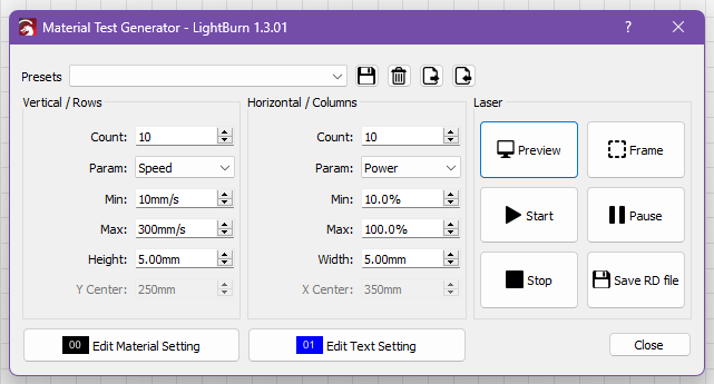

1. To run a material test, start by placing the material you want to test onto the bed of your laser.
2. Open up LightBurn and navigate to the top toolbar. Click on Laser Tools and select Materials Test.
*You can either use the default settings or adjust them to your liking.
Note:
Some lasers won't file under 15% you can change the min value accordingly.
Once the test is complete, you'll have a reference swatch that you can use in the future as a guide.
This simple process can help you achieve the best possible results with your CO2 laser, regardless of the type of material you're working with.

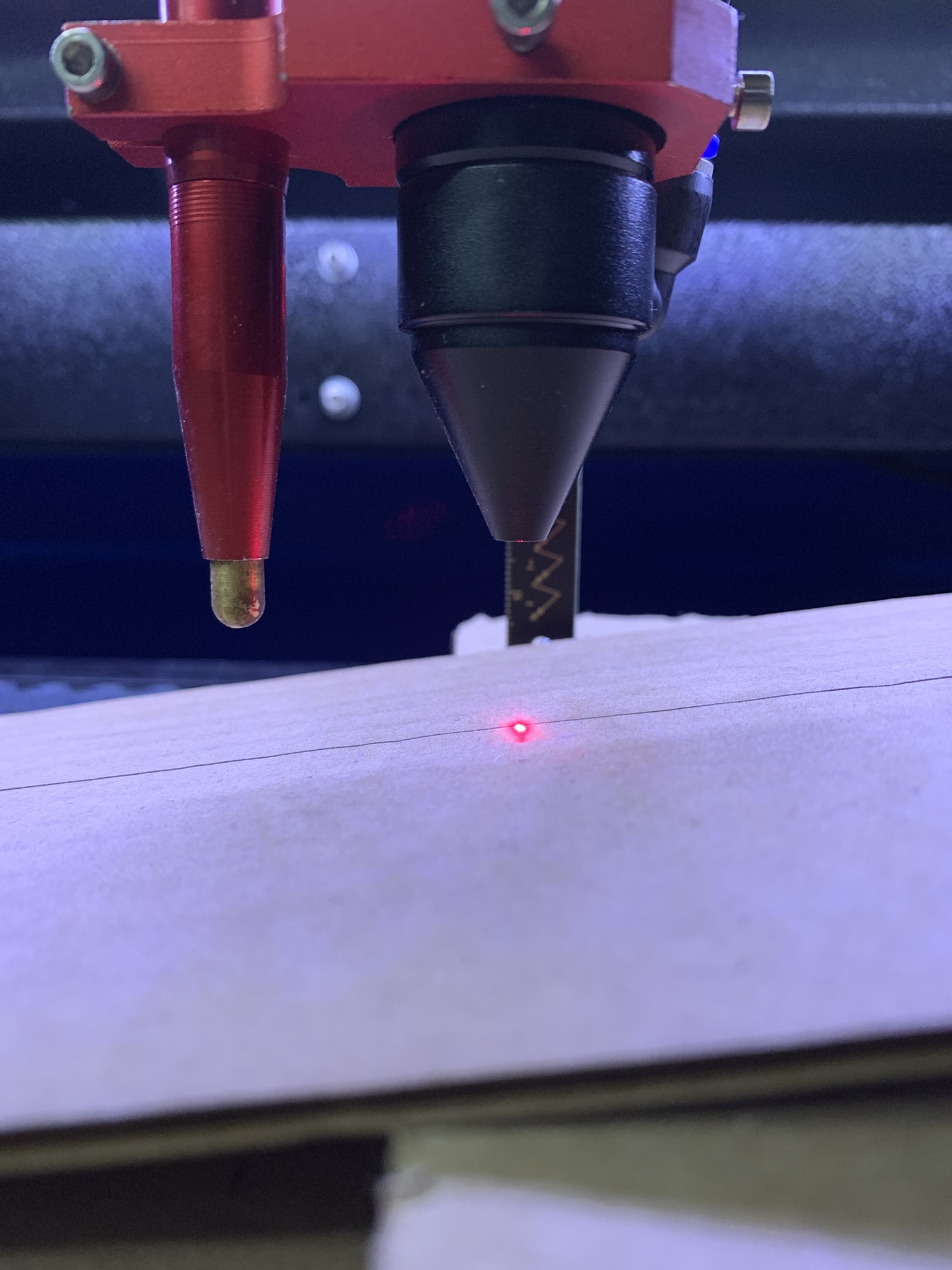

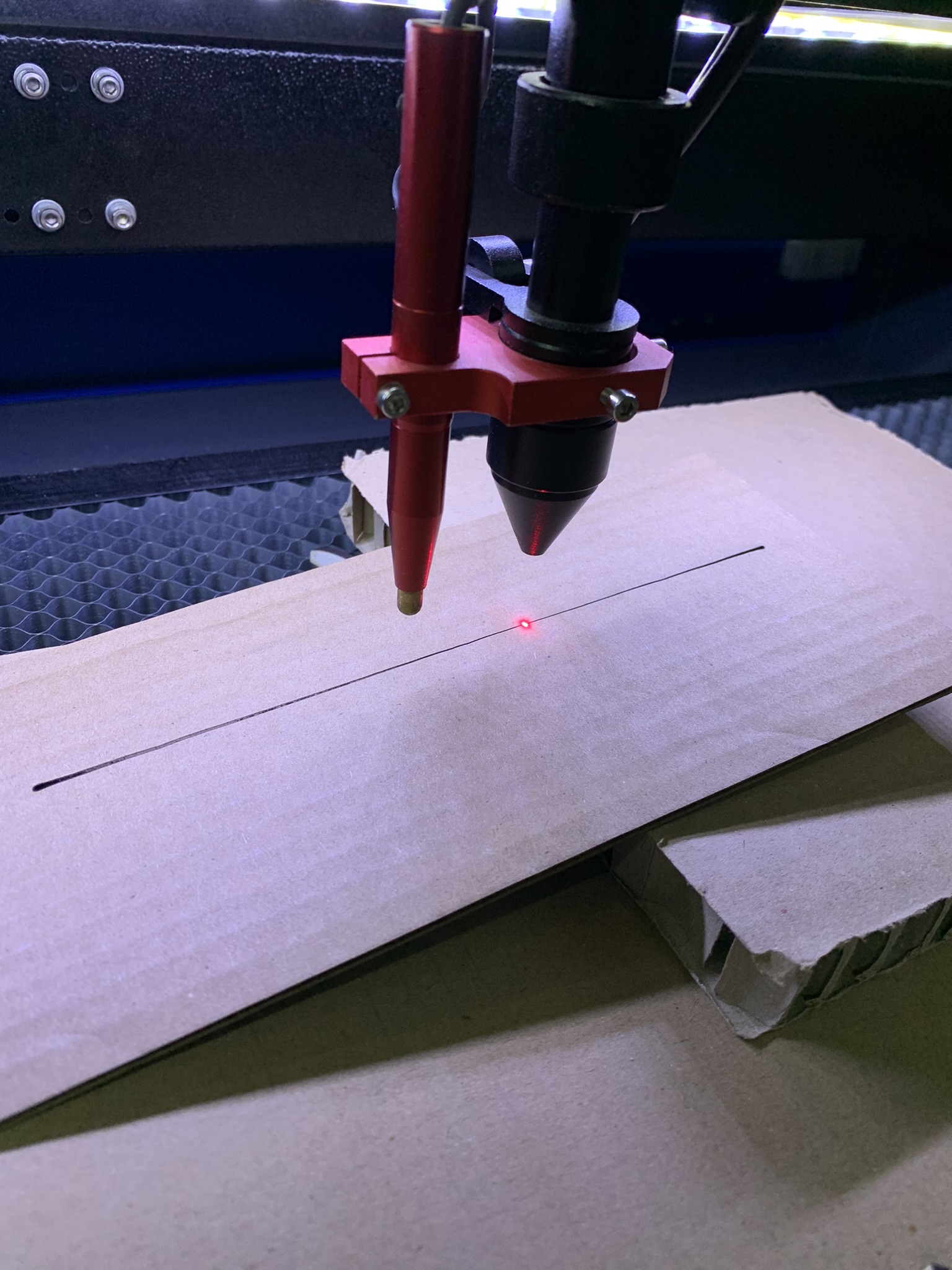

Performing a Ramp Test to Find Focal Distance
If you want to achieve precise and consistent results with your CO2 laser, it's essential to find the focal distance.
The focal distance refers to the distance between the laser lens and the surface of the material, and it can have a significant impact on the quality of your engravings and cuts.
One effective way to determine the focal distance is by performing a Ramp Test.
This simple test involves engraving a ramp on a piece of material and observing the changes in the engraving quality as the laser moves across the ramp.

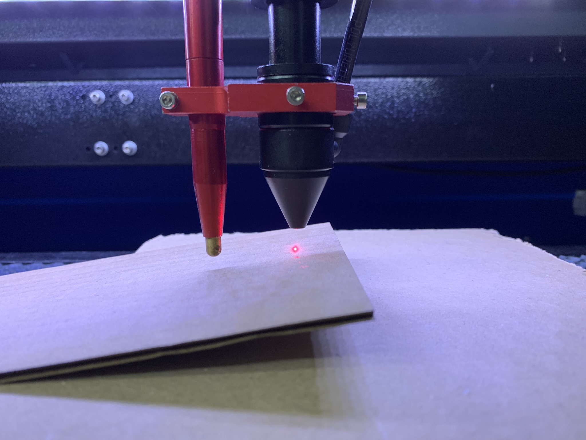

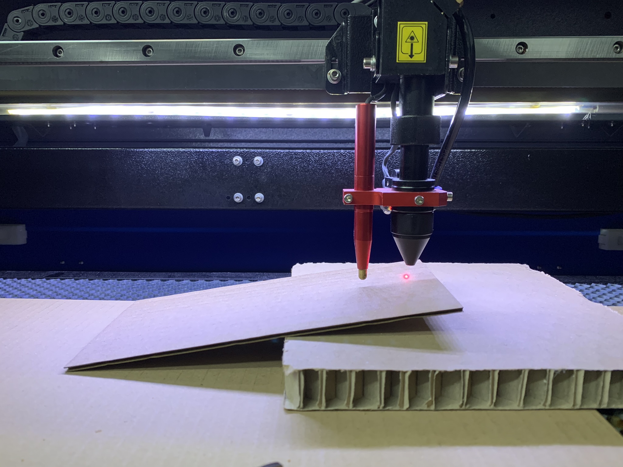

1. Start by preparing a piece of material for the test.
You can use a scrap strip of material to the width of your laser bed.
Place the piece across the bed and place a block under one end to raise it up approx. (2"-3").
2. Position the laser head
-Move the laser head to it is a few mm above the highest point of the ramp.

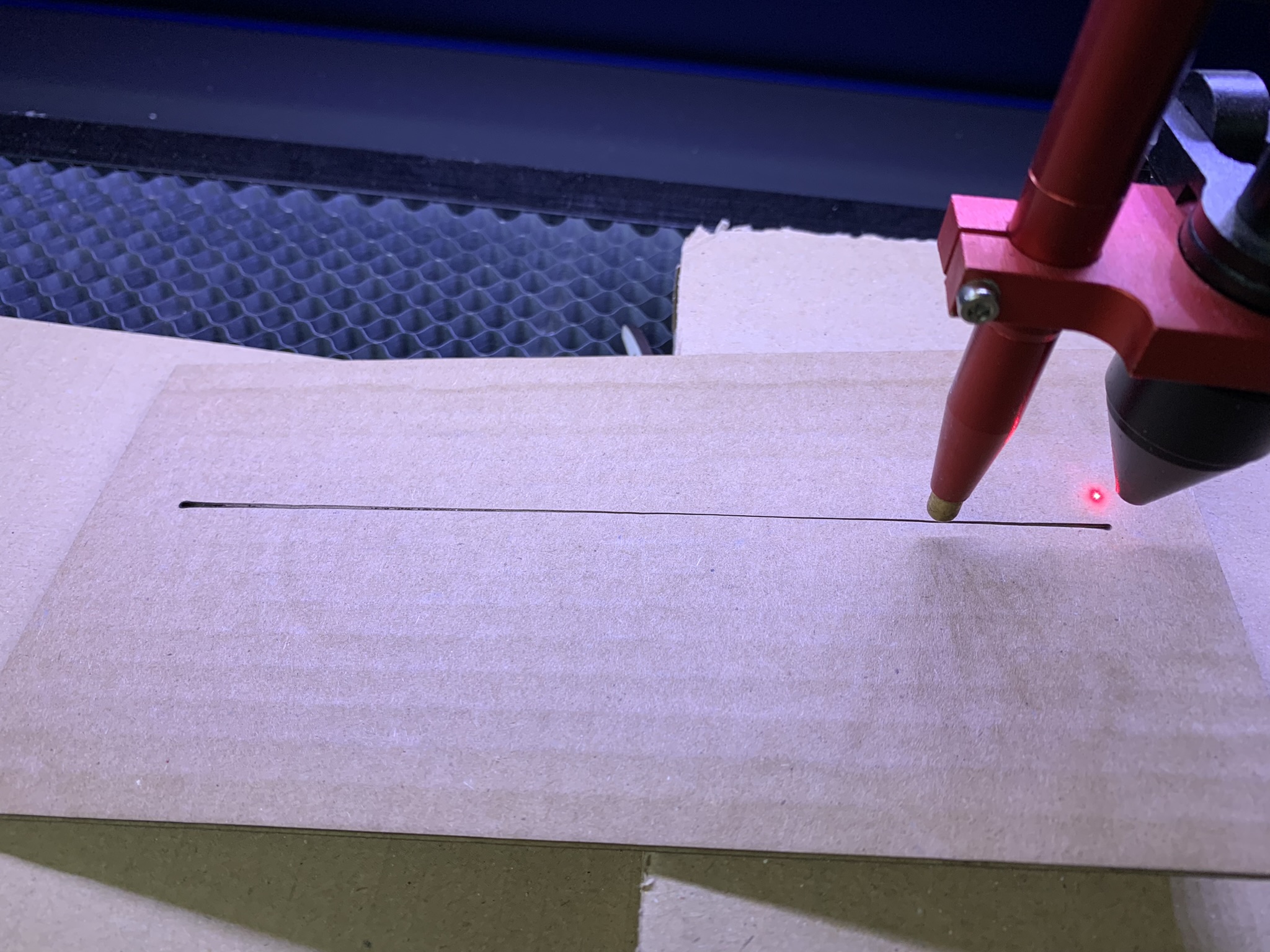

3. Setup the test
-Open up your laser software and create a single line the width of your material.
-Set your laser to 50% power and 200mm/s settings.
4. Run Test
-Frame the test, then send it to the laser.
5. Observe Results (Find Focal Point)
-You can now observe the changes in the engraving quality as the laser moves across the ramp.
-The point where the engraving quality is the finest is your focal point.
6. Measure Focal Distance
-Position the laser head directly above the focal point as closely as you can without moving the material.
-This is your focal distance, Record the focal distance for future reference.
-If your laser is equipped with a red dot laser, you can now easily point and align it on the focal point, ensuring that your laser is properly focused and ready for accurate cuts and engravings.
Note:
It's important to ensure that the material is positioned at the optimal focal distance from the laser lens before every cut or engraving.
Failing to do so can result in blurred engravings and difficulties cutting through even thin materials.
By taking the time to properly align your material, you can achieve the best possible results and avoid wasting time, money, and materials on failed attempts.
