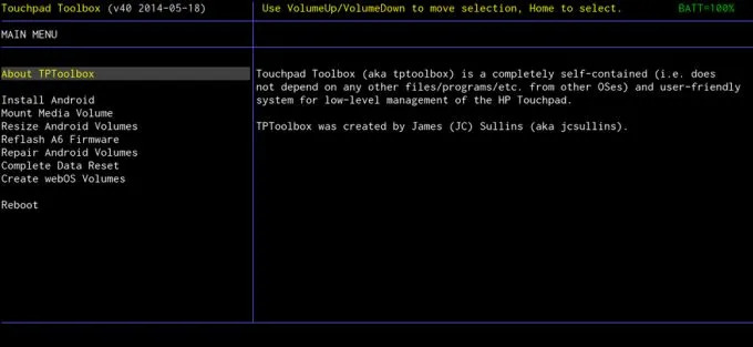

5. On tablet should now see a menu.
Use the volume buttons to navigate the menu and the home button to make selections.
6. The procedure will completely remove WebOS and Android from the device.
Scroll down to Complete Data Reset and select it with the home button and choose yes to begin the process.
7. Scroll down to Install Android from the menu and select it with the home button.
The TP Toolbox will mount the media partition/volume to your PC.

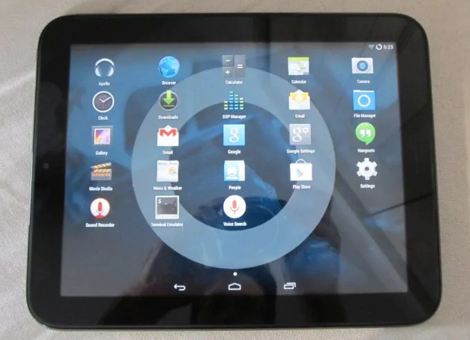

12. Once you see the welcome/setup screen your good to go.
13. Enjoy
